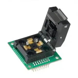

If you don't like extra headers, and you are assembling the board yourself, you can get a socket -- you put the unsolderd chip in, close the lid, program it, then remove chip and solder it in:
VPROG-1-S-LQFP48

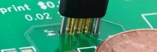

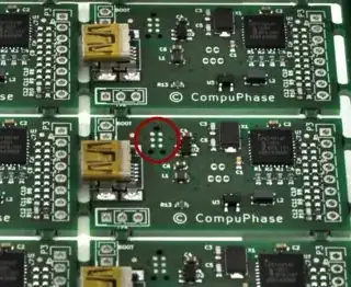

Another alternative is a small set of test pads (exposed copper with nothing connect to it) with the programming signals. You can then connect either via special "bed of nails" rig, or hand-held device like TagConnect:
example PCB from compuphase.com
Image source: CompuPhase - ICSP programming tool/adapter
TagConnect example
Image source: Tag-Connect - What is Tag-Connect?
