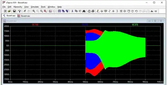

As for the Cs currents:
Balanced Boost Cs Currents
These are different but average out to be similar. Specifically, over the 40ms of operation:
  • Traditional RMS into Cs was 6.1374A.
  • Balanced RMS (Cs1) was 5.4478A.
  • Balanced No-Diode (Cs1) was 4.1483A.

    Have tried "harmonic" analysis. For D2, It is "pertinent" and clearly very "useful". – Antonio51 Jan 26 '22 at 20:46
  • I entered your testbench before you added the file source code to your very nice answer. I was wondering why my output was different from yours, and then I found that the three models are cross-connected via V2, V4, V6, and the gates of all 3 MOSFETs on Label G1, which I have as Labels V2, V4, and V6 on my testbench. – MicroservicesOnDDD Jan 26 '22 at 21:22
  • I also added a capacitor just like C27 and C41 on the Traditional Boost (but I'm not sure it belongs). And finally, I changed 470u to 480u on Traditional, all 100u to 120u, and 120u couplings to 0.99 on both Balanced, to try to more evenly match the inductances. And my inductors are not real ones. – MicroservicesOnDDD Jan 26 '22 at 21:25
Tried analysis of schematic in a particular case, did not include capacitor between Drain and ground, nor between source and ground.
Results are voltages inputs and currents main inputs (spectrum) for comparison.
So, clearly showing that the "D2" added diode is "useful".
Antonio51
  • 11,004
  • Is this quasi-peak such that the alternating peaks cancel? or is the BW high enough to show true peak conduction noise. – Tony Stewart EE75 Jan 27 '22 at 22:15
  • What simulator is that? – MicroservicesOnDDD Jan 28 '22 at 01:49
  • @MicroservicesOnDDD - Free simulator microcap 12 http://www.spectrum-soft.com/download/download.shtm – Antonio51 Jan 28 '22 at 05:42
  • @TonyStewartEE75 sorry, don't understand (BW ?) what you mean. The first picture shows that the second circuit (short-circuited diode D4) is noisier on current inputs. In particular, at the harmonics frequencies of the switching (20 kHz- 50% duty). (EE&O) – Antonio51 Jan 28 '22 at 05:53
  • NB: voltages are referenced to ground, and are noisy in the unbalanced case. But, If (Vg1-Vg2) and (Vg3-Vg4) are drawn (rectified sinusoidal wave), these voltages are obviously "clean". I did not show all current inputs which are obviously noisy in the unbalanced case ... – Antonio51 Jan 28 '22 at 06:05
