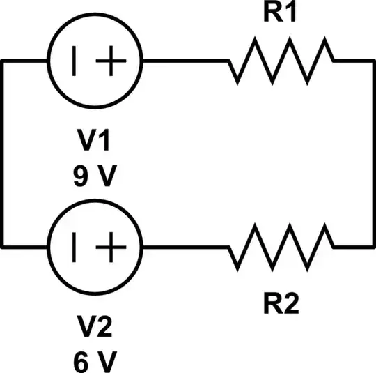

This is the schematic I made:
drawing of schematic
Since I cannot power my micro-pump directly from a digital pin (since it outputs only 12 mA), I am using a transistor (2N2222A) connected to 3V3 and to the control pin (D1.)
I did some more measurements with the multimeter and, apparently, the A0 analog pin actually reads the correct value (no need to divide or anything else). The problem that I have is actually multiple problems:
  1. When reading A0 pin with no load on the micro-pump (D1 pin is LOW) I get 1024 (the same way as the A0 would be connected to a 3V3 pin). Is the current directly flowing through the micro-pump when it is idling?
  2. When the micro-pump is working, with D1 control pin on full load (with digitalWrite(HIGH),) I get on the A0 about 300 mV (the same, more or less as I get with the multimeter.) With Ohm's law this means about 3 A, but in reality (measured with multimeter) I have 0.8 A.
  3. When I try to power the micro-pump with a lower voltage, by controlling the D1 pin with analogWrite, for example an 80% duty-cycle with analogWrite(205) I get on voltage of about 1.2 V on A0 (and also by multimeter.)
If I apply the Ohm's law on that circuit I get, in theory, 12 A! That is crazy, indeed, because the current measured with a multimeter when the micro-pump is running on 80% duty-cycle is actually about 0.4 A.
There must be something that I am missing here, since this circuit cannot be used to actually measure the current drawn by a DC motor.
BTW: I also tried to connect the end of the second BAT42 to the transistor emitter instead of the collector, but I get the same results.

    A 0.1 ohm resistor should not be 03. ohm. That's most likely a measurement error. Short the leads of your ohmmeter together and read the resistance. Next measure the resistance of the 0.1 ohm resistor, and subtract the value from the first reading from it. You could also just trust the 0.1 ohm resistor to be closer to correct than your meter. Typical hobbyist meters (in the hands of typical hobbyists) don't do well when measuring small resistances. – JRE Jan 20 '22 at 09:00
    The microcontroller on Wemos D1, is an ESP8266, which has an ADC range of 0~1V. because the 1V is not practical for hobbyists, board makers like wemos, use a voltage divider in the input so the user can measure values between 0~3.2 V. these not-so-precise resistors add some errors and lower the resolution of the ADC. (but not 10 times worse!) – Tirdad Sadri Nejad Jan 20 '22 at 09:19
  • @TirdadSadriNejad, that is indeed the case. See this question and answer [on Arduino StackExchange](https://arduino.stackexchange.com/questions/71949/voltage-divider-and-nodemcu-inputs). – StarCat Jan 20 '22 at 11:20
  • The analogue reading on the Wemos is extremely inaccurate and is also highly-dependent on whether your WiFi stack is powered up or not. The only reliable use for it is to detect if a signal is under or over a certain threshold voltage, but even then, you must calibrate your threshold by measuring what the readout is for a given voltage with and without the WiFi stack running. They will NOT be the same. – pfabri Jan 20 '22 at 14:02
The 2N2222A has a saturation voltage between 0.2V and 0.3V with this load current. This is the biggest part of the voltage you measure here, the additional 12mV across R2 are the minor part. You just don't measure a voltage across R2 alone here.
If you use a P mosfet as switch in the positive path of the motor and connect the lower end of R2 (and the cap) directly to GND, things are much better. Remove the lower (second) diode.
Another question is, whether the ESP ADC can properly read voltages below 0.4V, some can't.
