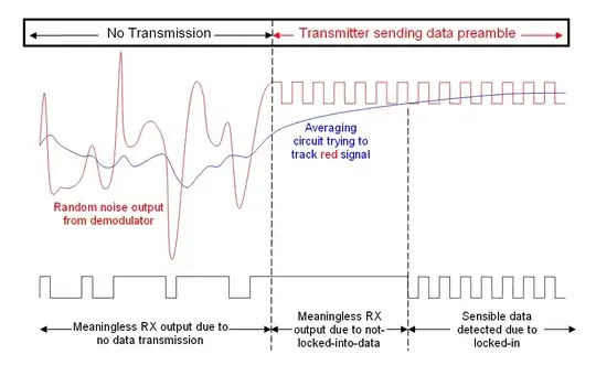

This may sound wasteful but, but consider that all radio data transmission systems have to use what is known as a data preamble when a packet is sent so that the receiver can align its RF circuits to the signal. The preamble is just a series of 1s and 0s encoded in such a way as to make it distinguishable from normal data. This preamble allows the receiver to lock-in to the transmission and decode initial data that doesn't form part of the payload message.
In other words, when the receiver eventually locks-in to the preamble, it expects data to follow. Here's an example for FSK data transmission but, it's pretty much the same for PSK: -
To the right of the picture is when real payload data would become transmitted (and hopefully received correctly).
Picture originally used here: -

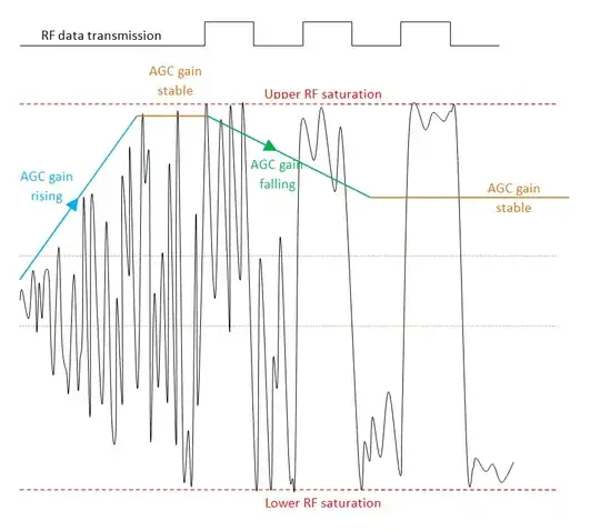

The links above may also make interesting reading. You might also be interested in how a receiver has to lock-in to the amplitude of a carrier. Clearly, if the modulation is pure FSK or PSK then the RF stage can operate at full gain and "lose" amplitude artefacts but, if a QAM scheme is involved then, an AGC circuit has to try and make the best SNR from the incoming RF signal as well: -
Picture from Why is this Arduino RF Receiver changing value back and forth so much?.
