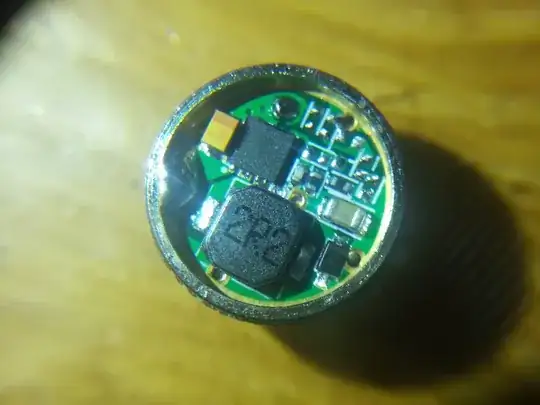

Such externally-charged '1.5V' Li-ion batteries have been around for a while, since 2014, initially made by the Chinese company Kentli. The Kentli battery and its competitors use a single 3.7V Li-ion cell, with the electronics housed typically in a 'hat' at the (+) end. Kentli's battery uses a recessed 'ring' that connects directly to the battery for charging as opposed to USB, and thus requires a proprietary charger.

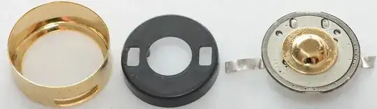

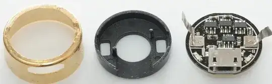

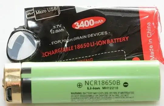

While not the one you are asking about, here are two similar ones. From https://lygte-info.dk/info/BatteryDisassembly18650usb%20UK.html is a usb chargeable Li-Ion cell. Note it is 3.7V (nominal output). It has a pair of charging ICs plus protection ICs, but has not output regulation.
enter image description here enter image description here enter image description here
While an older version required a 3rd non-standard contact as a ring around the positive contact for charging the Li-ion cell separately, but has a built in switching regulator for 1.5V output. From https://ripitapart.com/2014/12/06/teardown-of-kentli-ph5-1-5-v-li-ion-aa-battery/amp/
