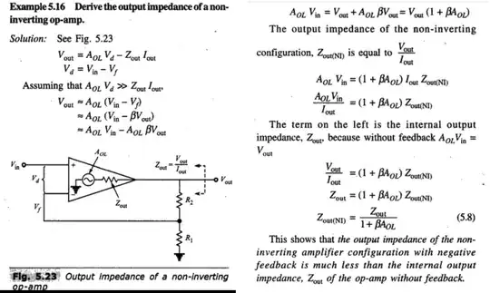

However, I have also found a derivation that seems not to do this (Example 5.16). I am assuming that because both derivations arrive at the same result, they are both valid. But where are the assumptions similar/different and why does one ground the input pin?
