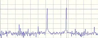

This is the waveform diagram of the STM32 hardware timer ISR executing (blue waveform), the flash write (green waveform) and the systick interrupt executing (purple waveform). Before the changes, the STM32 hardware timer interrupt would be blocked by the systick. After the changes, the STM32 timer interrupts would no longer be blocked.
Before putting Systick in RAM: before putting Systick in RAM
After putting Systick in RAM after putting Systick in RAM
