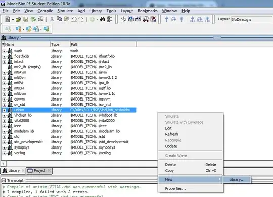

  1. compile UNISIM libraries by runnin compxlib and following wizard.
  2. then in your modelsim, library pane add new library.
  3. after that add library from existing library and point to folder which contains compiled version of unisim, e.g. it is C:\Xilinx\10.1\ISE\vhdl\mti_se\unisim for me enter image description here
    After that you can have fun with UNISIM :)
