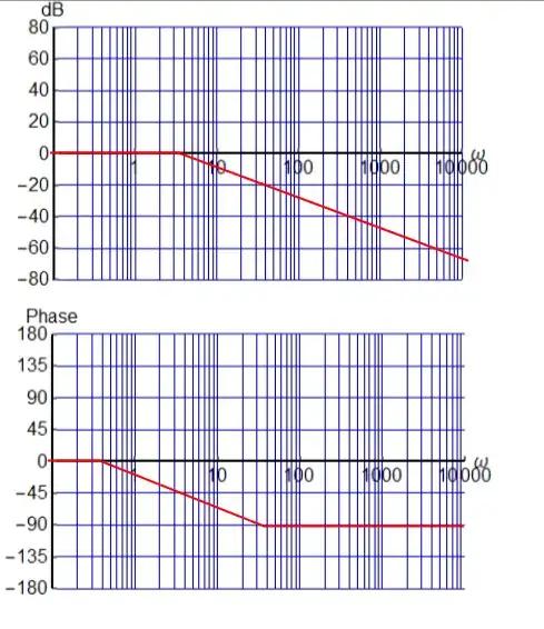

Your RC lowpass filter has the transfer function \$H(s) = \frac{1}{RCs+1} \$ and the frequency characteristic \$H(j\omega) = \frac{1}{j\omega RC+1} \$.
For the sake of understanding, let's say \$R=10\text{k}\Omega \$, \$C=27\mu\text{F}\$. So the frequency characteristic becomes $$H(j\omega) = \frac{1}{j\omega \cdot10\text{k}\Omega \cdot 27\mu\text{F}+1}=\frac{1}{\frac{j\omega}{3.70}+1} $$ From this, you can draw a straight line approximation of a Bode Plot, because we can read from \$H(j\omega) \$ that the cut-off frequency is \$3.70 \: \text{rad/s}\$.
Observations:
  1. At DC, the Bode Plot shows a gain of \$1 \frac{\text{V}}{\text{V}}\$ and \$0^\circ\$ phase shift \$\rightarrow\$ The Nyquist Plot starts at \$(1,0)\$.
  2. At \$0.37 \: \text{rad/s}\$ a linear negative phase shift starts but the gain is still \$ 1 \frac{\text{V}}{\text{V}}\$ \$\rightarrow\$ The Nyquist Plot goes clock-wise and maintains the same distance to the origin.
  3. At \$3.70 \: \text{rad/s}\$ the gain starts decreasing by 20dB/decade and the phase is still decreasing at the same rate \$\rightarrow\$ The distance to the origin in the Nyquist Plot is getting shorter and the plot still moves in the clock-wise direction.
  4. At \$37 \: \text{rad/s}\$ the phase is \$-90^\circ\$ and the gain is forever rolling off \$\rightarrow\$ The Nyquist Plot approaches the origin fast.
Below is a drawing is an approximate drawing I made in paint.net (I apologize for the bad penmanship), next to a plot of the Nyquist Plot made with MATLAB: -
