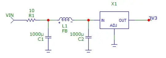

You can also cheat, by building a current divider, like so:
HF supply current for your micro will loop through local decoupling caps. Lower frequencies come from the LDO, which pulls that current from its input. I just used LM317 symbol for illustration.
The idea is to put a current divider at the input of the LDO with a pretty high resistor value and a large cap. You can also add ferrite beads to stop any HF noise from the micro leaking into your supply. When doing so, LDO input current will come from the lowest impedance source, which above 100Hz will be the capacitor. And the interesting thing is that your micro's ground currents will also return to the cap, not all the way to the power connector. So if you put the cap and the LDO somewhere in the upper left corner of your board, you can control the path your ground currents will take, and keep them away from the analog ground plane. You can even get fancy and use a second order RCRC filter, for example. Resistor value should be high, as you want voltage on the cap to ripple according to varying current drawn by the micro, so the current comes from the cap and not the power supply. If you want to be fancy, you could even replace it with a gyrator, to emulate a big inductor, but honestly a resistor is fine. This method works very well, but it needs a large cap, preferably with a low ESR. You've got low voltages though, so that won't be expensive.
If you want to minimize ground plane pollution, you also have to place your caps the opposite of the usual way. It tends to be "intuitive" to put the cap on the power pin because "duh it's a power decoupling cap". But if you put the GND pin of the cap next to the GND pin of the load instead, current will go through a shorter path in your ground plane. The ideal is of course when the chip has a nice pinout with GND and VCC next to each other so you can squeeze in the cap right there. But for the large pre-LDO cap, think about putting its GND pin next to the micro's ground pins. Doesn't matter if the power route to the LDO is 1cm longer. Basically something like that:
In addition, this large cap keeps the micro's pulsed currents not just out of your ground, but also out of the power supply, so it stays clean, and your opamps will be happy.
