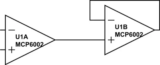

Instead, another solution that is safer and also requires no components, is to connect the output of the used amp in the package to the IN+ of the unused one. This assures that the unused one is always kept at a safe voltage, assuming the used amp's circuit is proper.
