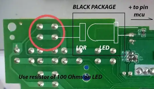

Use a VACTROL. Easy to use and also easy to make if you don't want to buy one.
Commercial variant: Vactrol
Home made with LED, LDR and schrink tubing: Vactrol homemade
Example Example
Benefits:
  • No need to mix circuits (does not require shared gnd)
  • No voltage or polarity issues
  • Completely isolated, cannot mess/blow up anything
  • Easy and safe!
How it works:
  • When pin is LOW, LED is OFF, LDR resistance is infinite (open contact)
  • When pin is HIGH, LED turns ON
  • When LED is ON, resistance of LDR is low (simulates a key press)

    I was having difficulty finding a PNP as recommended in another answer but did find a broken security camera and removed its LDR which does successfully flip the channel as you indicated. I will be constructing the LED interface next and appreciate your input since it seems to be the path forward for me. – Mike T Dec 28 '21 at 23:35
