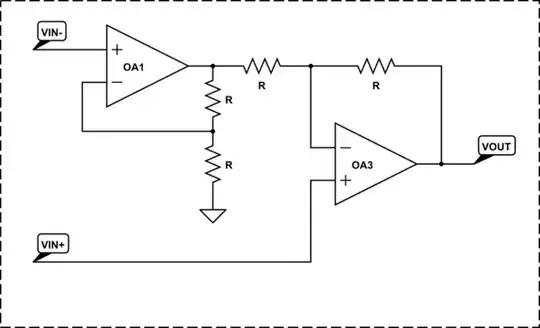

A basic instrumentation amplifier looks something like this:

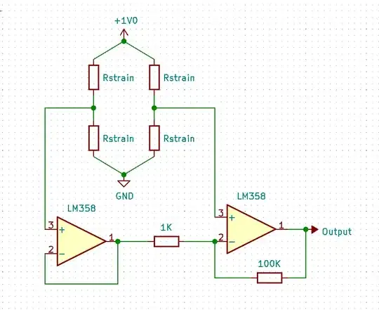

My understanding is that you can feed this circuit with a differential signal while not loading the signal too heavily because of the high input impedance of the op-amp buffers.
But why would I want to use this circuit if I can achieve the same result with a non inverting or inverting configuration with a single buffer.enter image description here Just like this one, having an inverting gain of 100 and having high impedance inputs, while consisting of fewer components. What functionality am I losing when sacrificing a differential configuration over this one.

To start with, you do not have the same |gain| from each input in your circuit, it is +101 from one and -100 from the other. That is a serious issue when it comes to rejecting DC CM voltage changes. I'll add a bit on AC CMRR once I fix your circuit.
Here is the circuit (2 added resistors to correct the gain) compared to the 3 op-amp
You can see that with 1 V common mode noise at (only) 1 kHz the output is about 120 mV so there is not much rejection. That is because of the lack of symmetry - the signal lags from the inverting input because of the extra op-amp.
At close to DC (here 1Hz) the difference is still there, but not nearly as serious.
At mains frequency you'll see in between those two numbers, about 8mV out with 1V 60Hz CM voltage or only about -20 dB rejection.
In reality, if you control or low-pass filter the noise, and don't need the best rejection, either circuit can work for you. For example, here is the simulation with 1 V (a lot) of 60 Hz noise and 20 mV of signal at 10 Hz. As you can see there's not a lot of visible difference.

In order to avoid CM noise issues using high DM gain and low CM gain is necessary for floating e-field from the lines at say 50V/m to amplify mV signal . Here your CMRR is 0 dB (CM = DM gain=40 dB) instead of 100 dB down or more with an INA. Using 3 Op Amps only gets you <<40 dB with 1% resistors, which will amplify SMPS CM noise if floating.
When working with differential signals, it's very important to ensure that everything that happens before the final summing stage will affect both inputs equally. The easiest way to accomplish this is often to pass both signals through circuitry that is as close to identical as practical. While a two-op-amp circuit could work as well as a 3-op-amp circuit if the first-stage op-amp on the inverting input behaved in ideal fashion, and non-ideal behavior could be compensated for reasonably well using enough precisely-tweaked resistors and capacitors, a much easier way to compensate for imperfections on the inverting input's first-stage op amp is to put the non-inverting input through an identical op amp. Using resistors and capacitors for compensation would require knowing the exact real-world characteristics of the first stage op amp, but when using the "extra" op amp in the non-inverting input all that would matter is that the real-world characteristics of the front-end op amps are close enough to ideal, and that they match each other.
