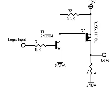

  • @Maple sure it is possible to design a circuit that does it. All you need is a high side switch, controlling the power supply to downstream devices based on the host VCC - basically what an powered USB hub would already do. However, this question was about making a simple cable which is not recommended. Or simply do it at your own risk - if the device is already non-compliant device pulling too much current, or the active cable non-compliant if it can't power the devices. – Justme Dec 18 '21 at 17:09
