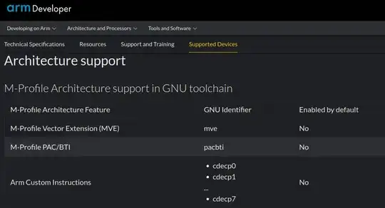

If you have simple IO requirements, perhaps the ARM GCC toolchain suffices for what you need. You end up with a straightforward commandline gcc, suitable for generating code for "bare metal" ARM processors. Perhaps this is what you need:
enter image description here https://developer.arm.com/Tools%20and%20Software/GNU%20Toolchain

  • The CubeIDE already contains gcc compiler. The point was to figure out a small "framework" how to make short programs fast. Armed with a bare compiler, it has no support for the peripherals, so you as the user must read the register manuals to initialize the MCU and each peripheral in order to use them. So that part is long to write which is why the frameworks and libraries exist. – Justme Apr 08 '23 at 07:27
  • Respectfully, the question asks about minimising tools ('my goal is to have a small bunch of files which can be easily compiled and do not depend on many "tools"') not on making programs quickly. I **completely** agree about the massive complexity of the IO. If you're just doing a little bit of GPIO, however, the gcc toolset can be pretty minimal. Hence the beginning of my answer "**If** you have simple IO requirements ..." – jonathanjo Apr 08 '23 at 07:33
  • The question asks "more smaller and simpler library for software development than HAL/LL/libopencm3/tinygo", which are not tools. You can have one tool, CubeIDE, and you can develop and debug HAL/LL programs out of the box (it does some file fetching for you), but HAL and LL consists of many files and complex include/source folder structure even if you only need to init the MCU and blink a LED. You can write no library programs as well, but you need to find everything yourself, including startup assembly code and linker scripts for your MCU, before you can start poking around registers. – Justme Apr 08 '23 at 07:39
  • @Justme I completely agree, it's a lot of work. It does have a very small toolset footprint, however, and for some developers that is important. – jonathanjo Apr 08 '23 at 07:48
