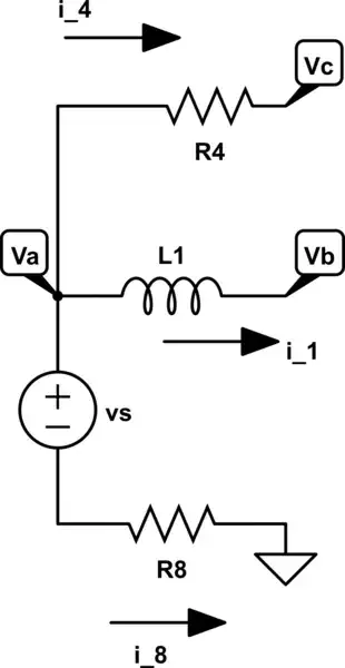

Let's look again at the two circuits, the one where the inner conductor is driven and the outer shield is grounded, and the other where the outer shield is driven and the inner conductor is grounded. The essential difference between them lies only in the placement of the ground symbol. However, the placement of the ground symbol has no physical significance at all, (unless the ground symbol is meant to represent a physical connection (say to a chassis, a "ground" wire, a grounding rod in the earth or something similar). That is, what we choose to call ground, or zero volts, is arbitrary.
Now, consider the following circuit.
There is a difference in voltage between \$V_{far}\$ and \$V_{near}\$, but I don't think we would say that there is a physical propagation of the sinusoidal voltage.
Now let us move the ground symbol (but make not physical changes to the circuit).
simulate this circuit
\$V_{far}\$ now has a sinusoidal voltage with respect to ground. But this is not really the result of a sinusoidal signal propagation between the resistor and \$V_{far}\$. Furthermore, the phase at each point of the wire between the resistor and \$V_{far}\$ is the same, and so the phase velocity is infinite.
