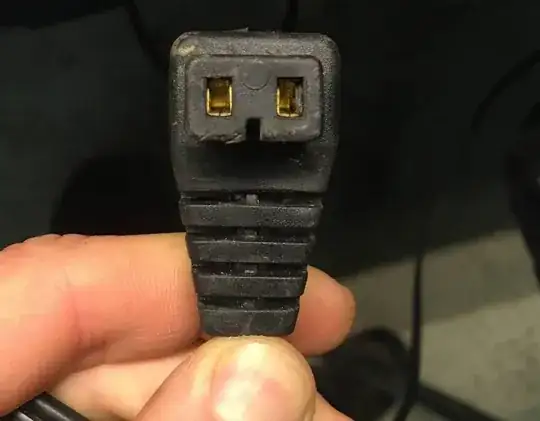

I'm seeking to buy this type of plug but can't find it anywhere. I tried asking at my local electronics shops, googled the images and consulted the data sheet of the appliance it came with. (12V input on an Indel B fridge.)
Any pointers would be appreciated. Thanks!
enter image description here enter image description here enter image description here enter image description here enter image description here

    I didn't know the answer, but I want to comment that you've posted a *very good* set of pictures for identifying a connector. Anyone browsing this question -- *that's* how you do it! – TimWescott Dec 10 '21 at 20:45

That looks like a C11 plug. Might be hard to find from a legitimate source since it was withdrawn from the IEC 60320 standard.

    *"...it was withdrawn from the IEC 60320 standard."* And has been for over twenty years. The oldest revision of 60320 I could find was the 2001 revision (2.0) and C11/12 were not included there. It would be a challenge even to find new old stock of these. Salvage is probably your best bet, or just rewiring the appliance to accept a different connector. – J... Dec 11 '21 at 16:07
  • As suggested, modifying the appliance would be easy. A connector like this would bring you back to current standards... https://www.amazon.com/Panel-Adapter-Connector-Socket-MXR/dp/B07DCXKNXQ/ref=sr_1_12?keywords=iec+c11&qid=1639484994&sr=8-12 – GT Electronics Dec 14 '21 at 12:32
    @GTElectronics the OP says it's a 12 V power input - that wouldn't be a correct use of a C13/C14 pair surely, as it would risk someone connecting mains voltage to it. – nekomatic Dec 14 '21 at 14:45
C11 connector that pairs with a C12 inlet.

Multiple brands of DC-powered portable refrigerator/coolers on Amazon use this connector type. You can find replacement DC cords and AC Power adapters by searching for them on Amazon.
