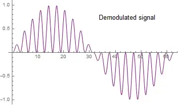

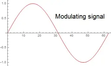

Pictorially, the process goes as follows: You have a modulating signal that carries some information. It is at a much lower frequency than the carrier.
You can transmit the carrier, but it has no information. If you receive one cycle of the carrier at the receiving end, that is all you need to recreate all the cycles.
If you mix (multiply) the carrier with the modulating signal, you get a modulated signal, that has information (embedded in the changing amplitude for now) and that can be transmitted using a manageable antenna size.
At the receiving end, you mix (multiply) the modulated signal with a locally generated carrier once again that should be at the exact same frequency to recover the information bearing modulating signal.
The modulating signal can now be recovered by low-pass filtering the carrier that was at a much higher frequency than the information signal. It is called envelope-detection in textbooks.
