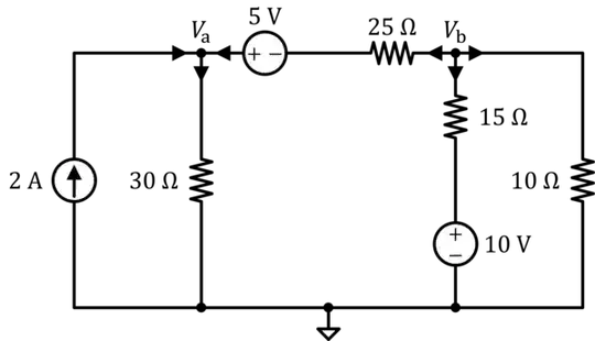

How would you solve this circuit with nodal analysis? I know it's the difficult route but it's a requirement. I understand that I need to create a super node that combines nodes a and b, and I have shown my equation below. However I am stuck with coming up with the second equation needed to solve the circuit.
My supernode equation:
$$\frac{V_a}{30} + \frac{V_B - 10}{15} + \frac{V_B}{10} = 2$$
For my second equation I tried a KVL in the middle loop but I get all the terms canceling out:
$$(0 - V_a) + 5 + (V_a - 5 - V_B) + (V_B - 10) + 10 = 0$$
where \$(0-V_a)\$ is the voltage across \$R_4\$, \$(V_a-5-V_B)\$ is the voltage across \$R_1\$ and \$(V_B-10)\$ is the voltage across \$R_2\$.

    Explain why you want to go down the torturous route of solving with nodal analysis. Anyone sensible (thinking practicality) would simplify first. – Andy aka Dec 05 '21 at 13:02
  • Im required to solve with nodal analysis – programmer25 Dec 05 '21 at 13:04
    So, if you are required to solve it using nodal analysis, then why are you potentially cheating by asking here for a solution? I think you might need to try a little harder at this or maybe consult with Chegg. This site doesn't like to give out answers to questions like this unless there is significant effort shown on your part. – Andy aka Dec 05 '21 at 13:07
    We won't do your homework for you. You are right, if your instructor requires that you use nodal analysis then you must create a supernode. There is no point trying to use KVL, you won't get any marks for that. Read about supernodes and come back if you have a specific question. – Elliot Alderson Dec 05 '21 at 13:12
  • Well Ive been stuck on it for a few hours, i dont often post questions on here, this is just a homework problem that i was hoping someone could help me understand. – programmer25 Dec 05 '21 at 13:13
    In this case, you don't need to use a supernode. For example o for node Va we can write $$\frac{V_A}{30\Omega} + \frac{(V_A - 5V) - V_B}{25\Omega} = 2A$$ Do you see it? – G36 Dec 05 '21 at 13:25
  • @G36 Hi, it turns out your KCL and my super node eqn provide the correct answers for Va and Vb. The textbook states that the usually a supernode and KVL combination is whats required to solve most problems but it seems this is a special case. Thanks for helping to shed new light on this problem! – programmer25 Dec 05 '21 at 13:56
  • @ElliotAlderson No, you ***never*** need a supernode to do nodal analysis. I've consistently shown it is never neccessary. The ***only*** reason it may be required is if a teacher ***requires*** its use in order to get a proper grade. Otherwise, it's silly and only adds useless fluff that one needs to memorize and keep "getting right" when that time and effort would be far far better spent on furthering basic skills. It's a dead-end, without value. It should be removed from teaching, except: historical notes, reference to materials for further study. Besides, not needed here. – jonk Dec 05 '21 at 21:09
  • @programmer25 Glad to hear you may have it solved, now. Did everything work out, okay? Or is there anything remaining? – jonk Dec 05 '21 at 21:15
  • @jonk everything worked out, thanks – programmer25 Dec 06 '21 at 01:42
  • @programmer25 Good to hear. Thanks! – jonk Dec 06 '21 at 01:47

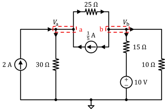

Here's my re-drawing:
The upper right side uses a Norton conversion of \$V_1\$ and \$R_1\$ on the upper left side. But they are equivalent.
As shown, you could continue from the upper left side by converting \$V_2\$, \$R_2\$, and \$R_3\$ into yet another Thevenin equivalent. And you could even do that one more time (not shown.)
In other words, this circuit can be reduced to almost an almost trivial approach for solving \$V_{_\text{A}}\$.

First, I will present a method that uses Mathematica to solve this problem. I know that this approach is not 'smart' but this method will work all the time, even when the circuit is way complicated than this one. This makes my answer valuable in my opinion.
Well, we are trying to analyze the following circuit:
When we use and apply KCL, we can write the following set of equations:
$$ \begin{cases} \text{I}_1=\text{I}_\text{a}+\text{I}_2\\ \\ \text{I}_3=\text{I}_2+\text{I}_4 \end{cases}\tag1 $$
When we use and apply Ohm's law, we can write the following set of equations:
$$ \begin{cases} \text{I}_1=\frac{\text{V}_1}{\text{R}_1}\\ \\ \text{I}_2=\frac{\text{V}_3-\text{V}_2}{\text{R}_2}\\ \\ \text{I}_3=\frac{\text{V}_\text{b}-\text{V}_3}{\text{R}_3}\\ \\ \text{I}_4=\frac{\text{V}_3}{\text{R}_4} \end{cases}\tag2 $$
And we also know that \$\text{V}_1-\text{V}_2=\text{V}_\text{a}\$.
We can use \$(2)\$ and \$\text{V}_1-\text{V}_2=\text{V}_\text{a}\$ in order to rewrite \$(1)\$:
$$ \begin{cases} \frac{\text{V}_1}{\text{R}_1}=\text{I}_\text{a}+\frac{\text{V}_3-\text{V}_2}{\text{R}_2}\\ \\ \frac{\text{V}_\text{b}-\text{V}_3}{\text{R}_3}=\frac{\text{V}_3-\text{V}_2}{\text{R}_2}+\frac{\text{V}_3}{\text{R}_4}\\ \\ \text{V}_1-\text{V}_2=\text{V}_\text{a} \end{cases}\tag3 $$
Now, we can set up a Mathematica-code to solve for all the voltages and currents:

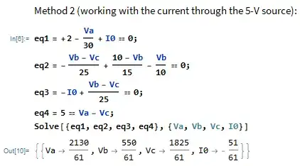

Method 2: Working with the current through the 5-V source as an unknown
In this method, we simply work with the current through the 5-V source as an additional unknown. Let's call it the current \$I_0\$, with the reference direction pointing to the left. Also, instead of just considering junctions (i.e. nodes with three or more interconnections), we'll additionally consider the node between the 5-V source and the 25-Ω resistor; let's call it node c. This is shown in the following circuit diagram.
Figure 4
Figure 4. Circuit diagram for the second method. Image source: own.
Applying KCL at node a:
\$ + 2 \text{ A} - \dfrac{V_\text{a}}{30 \text{ } \Omega} + I_0 = 0 \text{ A} \tag 3 \$
Applying KCL at node b:
\$ -\dfrac{V_\text{b} - V_\text{c}}{25 \text{ } \Omega} + \dfrac{10 \text{ V} - V_\text{b}}{15 \text{ } \Omega} - \dfrac{V_\text{b}}{10 \text{ } \Omega} = 0 \text{ A} \tag 4\$
Applying KCL at node c:
\$ - I_0 + \dfrac{V_\text{b} - V_\text{c}}{25 \text{ } \Omega} = 0 \text{ A} \tag 5 \$
Since there's now another unknown, we need a new equation. That's the constraint or auxiliary equation, which we get by expressing the voltage of the 5-V source in terms of the nodal voltages of the nodes adjacent to such source. Applying KVL around the loop aca (or by simply looking at the circuit diagram, and the polarity of the 5-V source and the location of nodes a and c), we get the constraint/auxiliary equation to be:
\$ 5 \text{ V} = V_\text{a} - V_\text{c} \tag 6 \$
Now you have four equations (eqs. (3), (4), (5) and (6)) with four unknowns (\$V_\text{a}\$, \$V_\text{b}\$, \$V_\text{c}\$ and \$I_0\$). The result is shown next; notice it's the same as in the previous method.
Figure 5
Figure 5. Solution for the second method. Image source: own.
