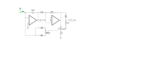

I've made a LTspice model of a diode bridge rectifier, but when I simulate my circuit, the input voltage is oscillating.
Here is my schematic, along with the simulation result of the voltage at node 3 (marked with an arrow.)
When I zoom in on these weird parts, I can see that it is definitely some kind of oscillation:
I've already tried changing the position of the ground, changing the solver to an alternate solver, and introducing ESR to the capacitor.
The problem seems to be correlated with the capacitor, since when I set a lower capacitance, the output gets better. The output also gets better when I set the capacitor ESR to a few ohms, but that is not very realistic.
I also tried with different diode models, and the problem persists.
Does anyone have an idea what could be the problem?
    1) Why do you have a 200 uH inductor in the circuit? 2) What happens if you **remove** the 200 uH inductor? *The problem seems to be correlated with the capacitor* Resonances like that point to an LC (Inductor, Capacitor) resonance, I only see one inductor and one capacitor in your circuit. – Bimpelrekkie Dec 03 '21 at 13:12
  • The node you have picked is not the output of the rectifier - it is the input. The output would normally be take from the junction of D1-D2 and D3-D4. Did you try the plain old 1N4001 diode for your rectifier? – JRE Dec 03 '21 at 13:27
  • @Bimpelrekkie 1) I need that inductor because it models the power supply network that I'm trying to simulate. 2) When I remove it, the problem is gone, so I think you are right - there is probably some resonance between the capacitor and the inductor. I just didn't think that was the case because I also tried using different inductor and capacitor SPICE models, and the result was the same. Thank you, I will see how to avoid that. – Ana Ćupurdija Dec 03 '21 at 13:35
  • @JRE Yes, you are right, I just didn't express myself correctly - I meant the output of the simulation. I will edit my post to be more clear. I tried with good old 1N4001, but the problem was there, too. – Ana Ćupurdija Dec 03 '21 at 13:36
