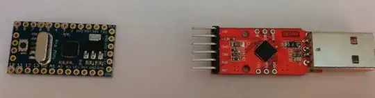

I am trying to identify a fried component in a fan controller. I believe the fan is a PWM fan, and my guess is that this component might be a transistor as part of the PWM circuit because that function is not working when I take readings with a multimeter (but this is a guess, and not a very educated one as I don't have the schematic for this board). It's a friend's fan controller and he fried it by accidentally sticking the DC power adapter plug into the fan molex connector instead of the power socket.
The component is Sot-23 (as per my measurements with calipers), and it has what I believe is "G1" marked on it (not 100% sure it's G1 because the component is fried, but I feel like I'm pretty confident).
Close up of fried component
Backed out a little
