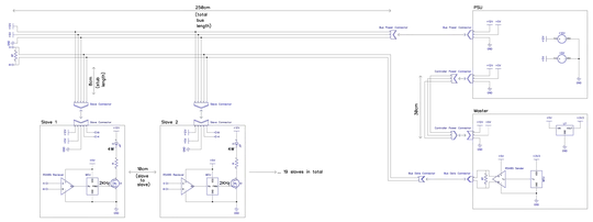

I am planning a system consisting of 1 master device which is connected to 19 slave devices using RS485 transceivers. Also, all devices are powered by 1 PSU. A simplified schematic is shown below.
Schematic
As you can see in the schematic, the slaves each control a 4W LED using PWM. I added this detail because I want to show that due to the switched loads a not unsubstantial current flows through the GND line. Therefore, due to the impedance of the GND line, the GND potential should be slightly different for each slave.
The bus should only be operated with a data rate of 250KBit/s. With a rise time of 180ns this would lead to a bandwidth of about 2MHz. However, I would also be very interested in what would happen if a data rate of 10MBit/s were used. With a rise time of 8ns this would lead to a bandwidth of 40MHz.
Since I am currently studying EMC aspects, I would be very interested to know the answer to the following question.
1.) How exactly do the current loops look when the master is communicating with the slaves?
While researching the exact operation of RS485, I came to the conclusion that the differential signal pair (A, B) of the transceiver are actually two single ended signals (Source 1, Source 2). This would mean that the current of the two signals would flow from the transmitter to the receivers and then back via ground. Thus, the outgoing and return paths of the current do not only consist of the signal lines A and B. So looking only on signal line A I came to the following current loop.
Schematic with current loop
The red path is the outgoing current path and the green path is the current return path.
Since this current loop covers a larger area and permanently conducts higher frequency signals, I am concerned that this could cause some EMC issues. Also, at higher frequencies, the current return path may seek other unwanted paths back to the receiver, as the GND line is likely to have a significant inductive component. So, I would be interested in the answers to the following questions.
2.) How can I design a better current return path even for high frequencies?
3.) Are there other communication standards that might be better for this purpose?

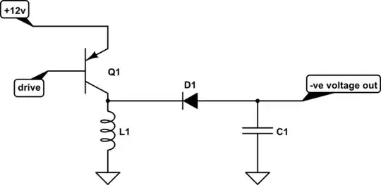

    You're missing a major part of this DC current flow. Most of the current flows though the two parallel termination resistors. – SteveSh Nov 26 '21 at 18:36

1.) How exactly the current loops look when the master is communicating with the slaves?
For high speed signals (not DC), the answer depends on whether the interface is stripline/microstrip (trace over GND) or twisted pairs.
In the first case, the return current for each signal of the diff pair flows directly under the trace carrying the signal, assuming the GND plane is uninterrupted. This is because the individual traces couple much more strongly to the return plane than they do to each other. It is a mis-statement to say that the + and - currents cancel. They each flow independently under their respective signal trace.
In the second case, the individual wires of the twisted pair couple to each other much more strongly than they couple to their surroundings. So in this case it is accurate to say that the current from one wire returns along the other.
Now if there is an imbalance in the two signals of the diff pair (slightly different delays or skews or amplitudes), this causes a common mode current to flow along both traces. This common mode current also flows in a loop, and needs to be returned back to the driving source. This current will flow such as to minimize the total loop inductance, which means minimizing the loop area of the current.
In the stripline/microstrip configuration, this return path is through the GND plane. In the twisted pair configuration, this path may be through chassis and structure connections (not desirable), or through the shield of the cable carrying the twisted pairs.

What you showed as the return path for current - the green path in your diagram - is correct for the input currents that flow into, or out of, the individual inputs of the diff receivers. This current is usually on the order of microamps or tens of microamps, depending on the particulars of the receiver you are using, and needs to return back to the driver. In your diagram, the green path is the only way for this current to flow. Note that there may be some other sneak path through chassis/structure involved, depending on how your power system is implemented and grounded. Also this current is more or less DC.

Signals A and B are complementary, but this doesn’t imply that one signal is a current return for the other. RS-485 is not a current loop.
The drivers and receivers must share a common ground. This is why “two-wire network” is a misnomer when applied to RS-485.
Differential transmission with RS-485 requires that the common mode voltage limits are met. The common ground should avoid larger potential differences between the stations. A galvanic isolation between several stations would not work.

You are neglecting that at the exact same time that one of the differential lines is going positive, the other is going negative. The two lines are terminated at their ends with a resistor (commonly 120 ohm). One output of the driver will be sourcing current, while the other will be sinking. This situation will reverse depending upon whether a one or zero is being transmitted.
The two currents are equal and opposite and do cancel. All that is left in the ground circuit is the DC current driving the inputs. The receives are high-impedance relative to the terminations so most of the current flows through the differential lines from one driver output then back to the other. Very little flows through the ground.
During transitions there will be some current into the ground into the capacitance that each line has to ground. This should be largely canceled depending upon how well the differential lines are matched - with perfect matching no ground AC current would flow at all.

  • @Michael - yes there will be ground currents induced by the transitions. But they will be canceled by the opposite polarity currents from the other output; The two lines need to be close together so as to minimize the loop area between the positive and negative signals. They would usually be spaced apart on the PCB to give the required differential impedance. Typically 120ohm for RS485. – Kevin White Nov 26 '21 at 19:26
  • RS-486 is not a current loop. Neither of the signal lines is ever supposed to go negative with respect ground under normal circumstances. Current is only ever sourced by the driver, not sunk. This current flows through the receiver(s) and returns through the ground wire. – brhans Nov 26 '21 at 21:29
  • @brhans That's not how RS-485 works. Based on logic 1 or 0 to be transmitted, driver will drive one data wire high to VCC and the other data wire low to GND so both data pins do source and sink current. – Justme Nov 26 '21 at 23:18
  • @brhans Neither signal line goes -ve wrt ground. That's true, but irrelevant. Current is only ever sourced? No, a low-going tranmistter has to sink the AC current component of the signal, regardless of whether it's still sourcing any DC current. The DC bias current is irrelevant in this context. – Neil_UK Nov 27 '21 at 07:01
