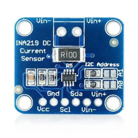

    You say battery ground is connected to sensor ground, but your diagram disagrees. You must also label the pins on your diagram, otherwise it is unclear what each wire connects to. – DamienD Nov 26 '21 at 09:04
I suspect you are using Adafruit breakout board or some knockoff. The documentation on Aadafruit site is messed up.
You have two wiring diagrams for current measurement, using screw terminals to connect on-board shunt inline with load.
And you have third diagram on the bottom for voltage AND low-current measurement, using pin header holes to connect VIN+, VIN- and GND to the load.
Note the difference! The GND connection is required to measure voltage.
If you want to measure high current, you need to use screw terminals to connect thick wires. But you can still use pin header to connect GND. I suggest consulting TI datasheet for wiring schematics and explanations how it works. It is much more informative than geared towards kids Adafruit site.

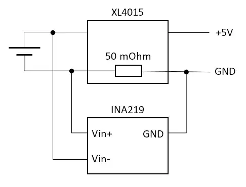

UPDATE
Important: the following is based upon assumption that XL4015 does have 50 mOhm shunt resistor in the negative rail.
The primary reason you have a problem is that INA219 is designed to measure bus voltage, not supply voltage. In the picture below (from TI datasheet) you can see that in bus voltage position of the input selector it measures between Vin- and GND. Some sensors, like INA260, are more flexible in this regard.
But not all is lost! Note that breakout board uses 100 mOhm shunt. What you can do is remove it and use 50 mOhm shunt on XL4015 board instead. By reducing PGA gain in half you will get exactly the same range with minimal changes in software.
You can also measure battery voltage between battery + terminal and common ground. The voltage drop on the shunt is negligible, but you can even account for it, since you measure it anyway, to get current reading.
So, begin with de-soldering the shunt from INA219 board. Then make the connections as follows:
The INA219 and Arduino grounds are now at same potential, connected to the output of DC-DC converter, so no problems here.
If you compare this schematics to the one from the datasheet, you should notice that in shunt voltage mode the polarity of inputs Vin+ and Vin- is reversed. However according to datasheet shunt differential can be negative:
So, you just have to account for this when you read conversion results. From the datasheet (8.6.3.1 Shunt Voltage Register): "Negative numbers are represented in 2's complement format". Convert this to positive number and you should have the same result as it would have been with original connections.

  • Hmm, that's a possibility. I think I'll cautiously hook on an OLED and code the Arduino to show me what's going with the INA219 readings, then try power the UNO up via the XL4015 5V output (as originally intended) with no USB to the computer. This will let me connect a common ground and see what happens. The XL4015 has a 50R resistor between its input and output ground, and the output ground will be the one to head off to the Arduino - could there be issues from this I wonder, with or without a USB connection? – Hoets Nov 23 '21 at 15:35
  • Are you sure about 50R resistor? First, it is way too large for current shunt. Second, ground is weird place for it, as it creates potential between supply and load grounds. This makes it problematic to measure battery voltage correctly, as you need GND to battery "-" for measurement, and you need GND to Arduino GND for communication. This is where galvanic isolation comes in handy, but it is not easy to use in this case. Finding DC-DC with direct GND pass-through is most cost efficient solution for this, IMHO – Maple Nov 23 '21 at 15:50
  • @Maple I have a similar board with current sensing in the ground (odd choice, right?) but the resistor value is 50 mOhm, so this part is probably a mistake. – devnull Nov 23 '21 at 16:12
  • @Hoets Can you, please, confirm what devnull is saying? 50 mOhm makes much more sense. And in that case I may have a solution for you that does not involve additional investment – Maple Nov 23 '21 at 18:42
