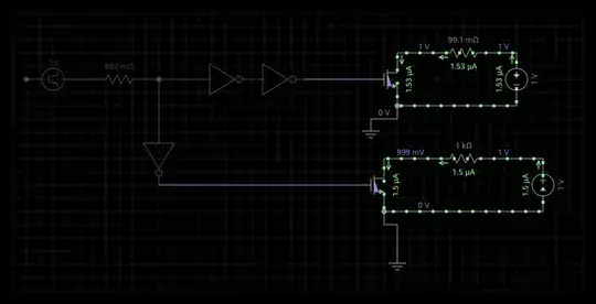

Now consider a second dipole antenna separated by 1 meter from the first, with a lamp across it's center-feed lines.
simulate this circuit
If the two halves of the upper dipole are originally at equal potentials, and the switch is flipped so that the battery is brought into the circuit, current will flow in the upper dipole. This will cause current to flow in the lower dipole as well. But will the currents in the two dipoles be equal? Only if the coupling between the dipoles is 100%. If the dipoles are 1 meter apart, and the wires are thin, then initially, we can expect the coupled current to be small. However, as the current spreads towards the ends, the the coupling may increase, (even though the conduction current will decrease as we approach the ends of the wires).
I assert that in Veritasium's thought experiment, it doesn't matter whether then ends are connected (as in his description) or not (as in the example immediately above) until enough time has elapsed for the EM signal generated by the flipping the switch to reach the ends of the transmission line. At least 1/2 second.
I therefore assert that for the first 1/2 second, the current in battery and switch side will NOT match the current in the bulb side.
