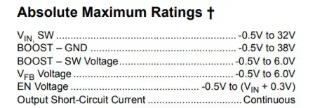

Second, in the Absolute Maximum Ratings you can see that maximum input voltage is 32V and EN pin can be 0.3V higher, i.e. 32.3V maximum. This confirms that you can connect EN pin directly to input voltage.
