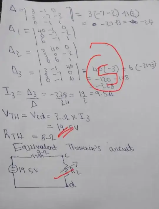

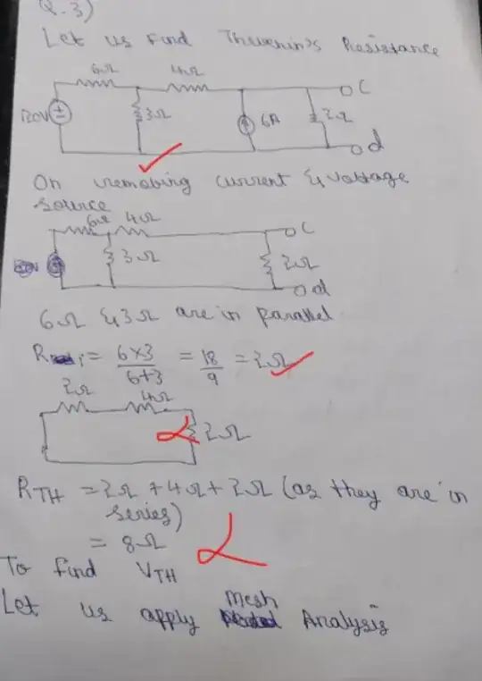

I am doing my first year of engineering and have EE as a compulsory course. My teacher recently gave this question in an exam. He gave me a 5/10. He is not answering anybody's doubts. Can anyone tell me what the right answer is/ where I have gone wrong. I have uploaded the evaluated answer sheets.
The question
My answers
My answers
My answers

    Regarding the determination of \$R_{th}\$, you see a resistance of 2 ohms across terminals c and d: the output resistance cannot be higher than this value and your 8-ohm value is counter intuitive. In your final step, the 6-ohm you've found is in // with the 2-ohm value (add the c and d points across the 2-ohm). For \$V_{th}\$, I did not go through the details, but I would have used superposition. – Verbal Kint Nov 13 '21 at 08:13
    What gave you the impression all 3 resistors are in series across terminals CD? – Mitu Raj Nov 13 '21 at 08:51
  • Aks, the voltage and 6 Ohm resistor convert to 20 A and 6 Ohm Norton. Then 6||3=2. Then 20 A * 2 Ohm = 40 V with 2 + 4 = 6 Thevenin resistance. Two ways now. But one is to convert the current source and the 2 ohm across c-d into Thevenin 12 V and 2 Ohm. So 40 V on one side, 12 V on the other, with 6 Ohm + 2 Ohm in series between. Output will be 40 V - 28 V/8 Ohm * 6 Ohm = 19 V. Another is to take 40 V and 6 Ohm and get Norton 20/3 A and 6 Ohm. Add 6 A to 20/3 A and multiply that by 6 || 2 = 1.5, to get 19 V, again. Many ways. But that avoids simultaneous solutions. – jonk Nov 13 '21 at 10:20
  • @MituRaj I think what OP's thought process when they made the mistake would have been to look at the circuit with all sources removed not from the terminal cd, but from another point. If they probably kept the current source as removed with an open circuit would have lead them to the right conclusion that the 2 ohm resistor is in parallel with the other resistors and not in series. – pseudomonas Nov 13 '21 at 17:35
Here's where your error is: -
You understood that you considered a series connection of the resistors rather than a parallel connection for \$R_{th}\$. When you have a resistance across measurement terminals - your 2-ohm resistance here - the resistance observed between the said terminals can only be less or equal than that resistance, at least in a simple linear circuit like here.
If I had to pass that exam, below is what I would have written:
Determining the resistance from terminals c and d is like determining a small-signal resistance in any linear circuit: set all sources to zero (a 0-V source is a short circuit and a 0-A source is open-circuited) then "look" through the consider terminals and infer the resistance you "see". Very often, inspection works and you can infer the value by associating in your mind the resistance you see. It becomes a bit more complicated with controlled sources but the spirit remains the same.
For the Thévenin value, I like superposition and here, inspection also works without resorting to many lines of algebra as shown in the picture. Determine the voltage when the current source is zeroed and then redo the exercise with the current source is alive while the voltage source is zeroed. The voltage you want is the sum of these intermediate values. I captured a quick SPICE schematic and a Mathcad sheet to verify my results. Of course you don't have access to these during the exam : )
