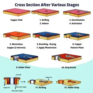

Often the PCB substrate begins with 17 µm thick copper. First step is to drill the holes, and then an electroless process is used to form a thin layer of copper on the inside of the holes. Then the trace mask is applied and electrolytic copper plating starts. This process adds copper to all exposed areas, bringing the total copper thickness to 35 µm typical (or any other thickness needed). It is important that the thin copper everywhere under the mask connects the traces together so that electrolysis works (it needs electricity to conduct).
Finally, there remains only the original 17 µm of copper to remove in non-trace areas. So the full thickness of the copper does not have to be removed. Furthermore, the copper in the etchant can often be recycled into copper for the plating process, though that requires some chemistry.
This Altium article on PCB processing provides a great overview, including this diagram: Processing diagram
