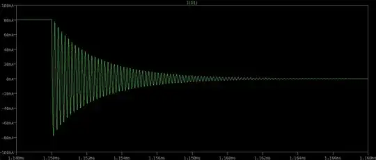

The PWM frequency is not so important, what matters is the rise times of the switch controlling the PWM. Assuming it is some sort of MOSFET, one can assume very fast rise times of 100ns to 10ns or even less.
1 meter of wire has a self inductance of ~1.5µH to ~1.8µH for a reasonable range of wire gauges. This inductance will be some what less if you run the power and ground cables directly next to each other which will cancel some of the magnetic field and thus reduce the inductance.
Unfortunately, LEDs are still diodes and they have some pretty nasty capacitance and non-linear voltage vs current behavior, so that coupled with the likely fast rise times of the PWM switch is going to cause the cable to ring at each turn-off transition with high frequency harmonic content.
It is impossible to say what the fundamental ringing frequency will be, it will depend on the cable and the LEDs, but it will ring at nearly the full LED current then decay over some microseconds, similar to this:
The ringing frequency is probably going to begin at single digit MHz then have harmonic content all the way to the maximum harmonic as dictated by the rise time of the switch. The actual power at harmonics that a 1 meter cable would be an effective radiator at would probably be fairly low but given the current levels, potentially still worrying.
