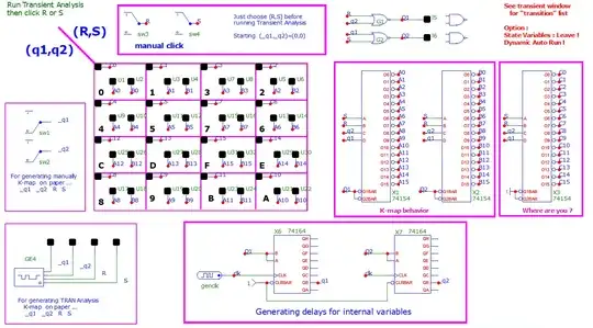

For helping understanding "how RS latch" works, I have tried making an "interactive" k-map ... (a bit "difficult" with simulator).
Same delays for the two NOR gates.
See also https://www.ee.ucl.ac.uk/~ademosth/E757/Topic6.pdf
Outputs are named in general : Q1 and Q2 !!!
My k-map :
I used microcap v12
(K-map is not displayed, only the state where you are, see example). How to insert too long text file circuit, or link ?
Starting with one (R,S)=(0,1) configuration, (_q1,_q2)=(0,0). start case 1, go to case 9, see transient window. enter image description here
Going to (R,S) = (0,0) -> case 9. Direct jump. No transient case.
Now, manipulating R, going to (R,S)=(1,0) -> from 8 to transient cases A, 2, finally 6.
You can even show the "oscillation" of this RS-latch ...
Only in "Transient window", because between "instables" cases and transitions.
Nota : if the delays are not the same, it is not the same behavior !!!
Starting from (R,S)=(0,0) ... Oscillating between 0 and C cases.
If _q1 is faster then _q2 ... this occurs ... (_q1,_q2)=(0,0) then (_q1,_q2)=(1,0).
