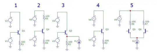

Now look at this emitter follower:
On schematic #1, if the intent was to drive a votage on the load resistor, then the output would be the emitter. But if the intent was to make a current source, and drive a current into R5 (schematic #2) then the output would be the collector.
Now, if the emitter resistor R4 was not constant but instead variable, and the base voltage was constant, and the intent was to have the transistor set a constant voltage across this resistor to measure its value by measuring current flowing through it, said current being sent into the collector resistor... then it would be called "common base", but the circuit didn't change much.
#3 If you put an AC current source on the emitter to measure its output impedance, then the output also becomes an input.
#4 If you put an AC voltage source on the collector to measure the Early effect, or the supply rejection ratio, of your emitter follower, then the collector is also an input.
#5, the differential/LTP. What we're interested in is collector currents, so we decide it's the output. We input some signals on the bases, so they get an "input" label. The transistors themselves don't care, and besides, the question of what the emitter is in this case is quite interesting: it is an output because each transistor works as a follower, but it is also an input because each transistor influences the other's current through its emitter. So it combines common collector and common base.
So, basically, all three pins are both input and output, and it's more about impedances, gain, and intent:
