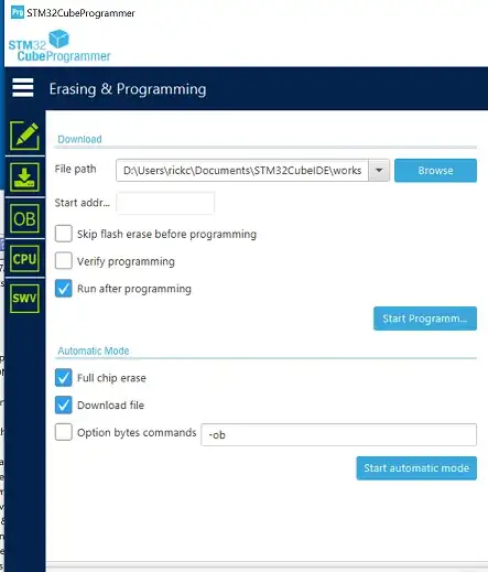

I can modify and build my application using STM32CubeIDE however in order to run it, I have to program the STM32F3DISCOVERY board using STM32CubeProgrammer and use the Erasing & Programming tool to download the .elf file that resulted from the build. In the past I was able to do everything in STM32CubeIDE.
screen shot of STM32CubeProgrammer download screen
