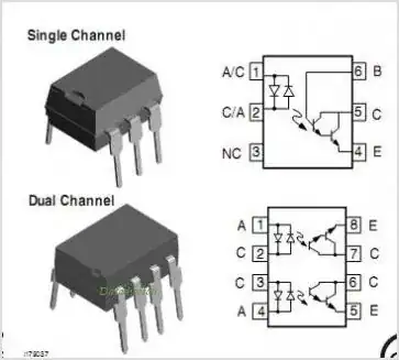

This is an AC input optocoupler:

  • This question has been answered here before. http://electronics.stackexchange.com/q/4679/9079 or just search for "zero crossing" - you'll find tons of good info. As for single device, I think you'll have to use two inexpensive optocouplers - one "AC input, open collector output" and one "triac output" – miceuz Feb 24 '13 at 22:10
    @miceuz, from the **stevenvh**'s answer in the pointed thread, I will be needing a special opto-coupler, one with two diods in parallel. My question is further asking if there can be found such a thing, in a combination with a triac output (to drive my triac). I imagine this will be a cheaper and simpler solution than using separate chips. – Vorac Feb 24 '13 at 22:24

I've looked, and I haven't found any devices which combine optoisolators in both directions. You had best use 2 devices.
