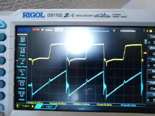

Enter image description here
So this is the gate-source voltage driving the MOSFET and in blue the drain current through a 3 ohm resistor. This is the exact same setup as in simulation where the exact same thing happens:

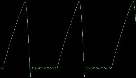

(the current is just inverted)

The current wave form is actually created by the parasitic drain-source capacitance (CDS) together with the body diode. When the MOSFET goes open, its CDS together with the inductor resonate in series while their peaks are decreasing:
When adding the body diode, the ringing is rectified and filtered giving the replica of the original current wave form:
Now the duty cycle can be adjusted to move them both together. I'm not sure why the slope equals the inductor slope though. There is more to this, but this answer seems satisfactory.
