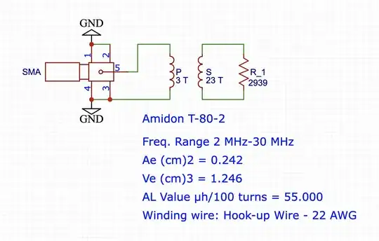

I am preparing to do some RF mixer experiments with the SA612 Gilbert cell mixer. I started out with the impedance matching as I understand that the input and output need to be matched. From what I read, the impedance should match 1500 ohm single or 3000 ohm in a balanced configuration. So I need to match 50 to 3000 when using a balanced configuration.
I decided to try winding a toroid. I used a T 80-2 (red, which should be good below 30MHz) with 23:3 turns:
But before I move on, I would like to measure it. I don't have any experience with this, so I would like to get a feeling if and how well it performs.
But how? I have some basic equipment (scope, signal gen, nanoVNA, etc,) but I don't know how to approach this.
At first I was thinking of doing some tests with the nanoVNA (I'm no expert in using it). I figured an SWR value would give me a good indication. But I wasn't able to get a good reading (I got extremely high or even negative SWR values). Maybe because the setup I used (I terminated the high-Z side with 3000 ohms as if it was connected to the SA612). I also wondered how this would work, I mean, doesn't the nanoVNA just see an inductor (the primary side of the transformer) and doesn't this not just act like one (with somewhere a dip where it's resonant)?
Then I figured I could do some measurements with my signal generator and an oscilloscope. I connected the signal generator to the low-Z side and tried to measure the high-Z side which was again terminated by a 3000 ohm resistor (gnd and probe on each side of the resistor). I could not get any reading (even at the lowest setting in the mV range and with 10 Vpp). I inserted a 50 ohm resistor in series with the signal gen to see if the signal is visible at the input side and it was as expected.
So, now I have built myself this mysterious device that should work, but which I can't measure...
My question: Can anyone explain how to measure an impedance transformer? And please elaborate and be explicit, as I am quite new to this particular area.

Test setup for measuring impedance:
Result after calibration (calibrated at the end of the cable used):

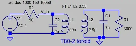

The LTspice run shown below roughly represents OP's VNA test setup. The 7pf capacitor is a single component representing the inter-winding capacitance. Self-resonant frequency shows up at about 37 MHz in the frequency-sweep plot. This transformer would be useful at that frequency (if turns ratio was adjusted for a proper impedance match). When attached to the mixer chip, this resonance would shift to a lower frequency because of the added NE612 output capacitance of a few picofarads.
LTspice schematic LTspice frequency plot
At lower frequency, the winding inductance is too low compared with the associated resistances...the 50 ohm source sees an inductive reactance that is much lower due to the 3-turn winding. For a wideband transformer, inductive reactance should be significantly higher than the 50-ohm source resistance at the lowest frequency of interest. In the LTspice sweep plot, phase seen by the VNA (at V_in) is near 90 degrees, indicating that it is seeing mostly inductance rather than resistance.

In the example below, the 3000 ohm side of the transform is connected to TWO equal windings...in this mixer circuit, the center-tap could be connected to SA612's DC supply voltage point - a point of symmetry. Each L2,L3 winding is 12 turns. The L1 winding to the 50-ohm source has three turns - the turns ratio of (12 + 12):3 is a reasonable match for 3000:50 ohms when coupling is 100%.
LTspice cannot easily model the internal ferrite losses, which are frequency-dependant. Because few turns are required on a smaller core, inter-winding capacitance is a bit smaller than the previous case.
This transformer provides a reasonable match over a span of frequency from a few MHz to about 20 MHz - this might be called wide band. Note that phase angle seen from the driven 50-ohm end is low, indicating that resistance dominates the transformer's inductive reactance. Ideally, amplitude at V_in should be -6 dB, if impedance is properly matched to the 3000 ohm load.
ferrite toroid schematic LTspice wideband AC plot Bear in mind that matching such a high impedance over a wide bandwidth is difficult. Wide-band matching low impedances is much easier.
There is no evidence that the toroid you picked is actually any good below 30 MHz at all. You need to examine the data sheet and the performance graphs for the material to make this judgement. In my experience, you cannot assume it will be any good.
Anyway, moving on, let's assume it is good for frequencies up to 30 MHz. To make this assumption and knowing that it is a toroid (no gaps) it must be made from specialist low permeability material. It might have an inductance factor in the region of 100 nH per single turn for it to be good up to 30 MHz.
With three turns, that's a total primary inductance of 900 nH. If your operating frequency is (say) 10 MHz, 900 nH has an impedance (irrespective of what you connect to the secondary) of 56.5 ohms reactive. At 1 MHz the impedance is 5.65 ohms reactive.
So, if your testing frequency is 1 MHz (or lower), it's going to have a pretty shabby input impedance and not at all operate as an impedance transformer.

The above table extracted from this data sheet.
As I suspected; it's a very low permeability core with 100 turns producing an inductance of 55 μH. Given that inductance is proportional to the square of the turns, the inductance of 1 turn will be 100² lower at 5.5 nH. Hence, 3 turns will be about 50 nH. At 10 MHz, this has a loading impedance of 3.11 Ω reactive and will just get linearly worse at lower frequencies.
