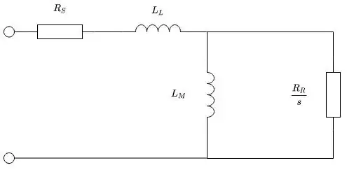

My intention is to transform the above given state space model to a different state space model which will contain parameters of the \$\Gamma\$ equivalent circuit of the induction motor.
This transformation basically means that the state variables changes due to the fact that the leakage inductance of the stator winding has been moved onto the rotor side

My problem is how to write the matrices of the \$\Gamma\$ based state space model i.e. \$\mathbf{A}_{\Gamma}, \mathbf{B}_{\Gamma}, \mathbf{C}_{\Gamma}\$ in such a manner that they contain in their elements only the parameters of the \$\Gamma\$ equivalent circuit i.e. stator resistance \$R_S\$, magnetizing inductance \$L_M\$, total leakage inductance \$L_L\$ and rotor resistance \$R_R\$. There are following formulas for conversion of the parameters of the \$T\$ equivalent circuit into the parameters of the \$\Gamma\$ equivalent circuit
$$ R_S = R_s $$
$$ L_M = L_s $$
$$ L_L = L_r\cdot\frac{L^2_s}{L^2_h} - L_s $$
$$ R_R = R_r\cdot\frac{L^2_s}{L^2_h} $$
I have attempted to made some modifications in the elements of the matrices aiming to exploit the formulas for the \$R_S\$,\$L_M\$,\$L_L\$ \$R_R\$ but I always stuck in a situation where let's say \$R_r\$ is multiplied by the desired "transform" coefficient \$b=\frac{L_s}{L_h}\$ but the necessary modifications create very complex expression from the rest of the matrix element which doesn't contain none of the formulas for the \$R_S\$,\$L_M\$,\$L_L\$,\$R_R\$. I have also attempted to use the wxMaxima software for the symbolic calculations but without success.
