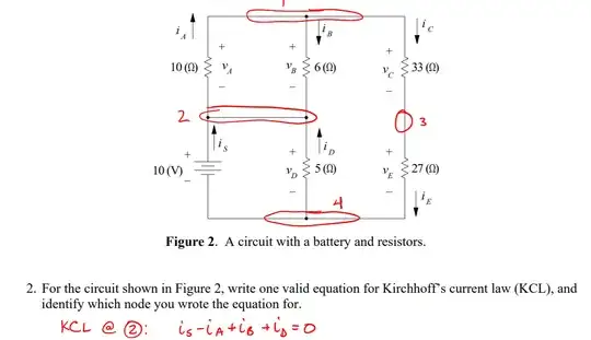

Hi I was wondering why the i_A is negative in the answer in the photo, it was the only one that ended up not being right when I did the KCL on my own, what would have been my mistake as to why I ended up with a positive instead?enter image description here

  • Easiest way to do these is to just write a sum of all the outward directed currents on one side of the equation and a sum of all the inward directed currents on the other side. Then re-arrange as pleases you. – jonk Oct 03 '21 at 23:19
  • Don't get confused when it comes to signs. The signs before a current or voltage in a KVL/KCL eqation don't say anything about the direction in which the current is travelling for real. The direction of the arrows can be chosen randomly. They serve the purpose to define the direction for your symbolic calculations once to avoid any confusion later. – Ariser Oct 04 '21 at 10:18
Because, as drawn, \$ i_A\$ is the only current leaving node 2. All the others are inbound.

Suggestion
The first thing I do before attempting to analyze a circuit is to redraw that circuit. The process of just doing it helps me think and gather up a few details that I may not notice so easily, just staring at someone's depiction. But I can often help the readability, too, which improves understanding and reduces chances for mistakes, later.
It takes lots of practice to accumulate a good sense about it. But that practice is well worth your time.
You should use the built-in schematic editor here. It will add part numbers and this is very important for saving time and confusion when communicating in comments or in answers. In your specific case, the values of the resistors can be used to identify them. But in general, you should assign separate designations as it won't always be the case that the values are all different from each other.
And finally, keep in mind that you get to call one node "ground." If you select a really convenient one, it can greatly simplify the analysis and reduce chances for mistakes, as well. (This doesn't always have to be the obvious choice or the one that the writer chose. You can move it to a different location if that helps your analysis.)
Redrawn Schematic
Note that node 2 is missing? It's not needed.
KCL Analysis
There is only one KCL equation:
$$\overbrace{\frac{V_1}{R_1}+\frac{V_1}{R_2}+\frac{V_1}{R_3+R_5}}^{\text{outward currents}}=\overbrace{\frac{+10\:\text{V}}{R_1}+\frac{+10\:\text{V}}{R_2}+\frac{0\:\text{V}}{R_3+R_5}}^{\text{inward currents}}$$
So it's not as though there is much of a useful choice.

KCL Addendum
The KCL equations may appear to treat node voltages as if they don't have to be differences, but can be absolute values. However, that's not really the case here. In fact, I'm just using superposition (which is easily seen once you've really had the concepts deepened into you.) This is, in fact, the same technique used within Spice programs (those where I've directly looked over the code used to generate these.)
Perhaps the easiest way to imagine is that absolute voltage at a node spills away from that node through the available paths. But also that absolute voltages spill into that node from surrounding nodes through those same paths. So long as you treat them all as absolute values, the result is the application of a simple superposition concept that results in, effectively, the potential differences controlling the result.
You can test this, easily, by rearranging the resulting equation(s), moving the right side over to the left side and then combining terms. You'll then see the usual potential differences that you expect. So it really is the same result.
The reason I very much prefer this method is that it is simple to visualize and very difficult to make mistakes. You can easily orient yourself to a node and then work out the terms for out-flowing currents for the left side of the equation. Then all you have to do is position yourself at each surrounding node and work out the terms for in-flowing currents for the right side. It's almost impossible to screw that up.
Conversely, when you are instead struggling to work out the potential differences in your mind (using the more traditionally taught method) and just write those terms, you often find yourself not entirely sure if you have the sign right as you try and add them up, correctly. I find, time and time again that not only others wind up messing up somewhere and making an uncaught mistake.. but that I also make those mistakes, as well. Even with lots of experience, you just aren't 100% sure and you often find yourself double and triple checking your work, just in case.
That doesn't ever happen, once you start using the superposition method. It just works. It just works right. It just works right each and every time. I've never, not once, screwed up. (I make typos. But not sign errors.) It's too easy to use.
So voltage spills away from a node via available paths and voltage spills into a node from nearby nodes via the same available paths. The only caveat is that a current source or sink can only flow in, or flow out, but not both directions. It's one way. So it will either appear on the out-flowing side or on the in-flowing side -- but not both sides.
This also works perfectly well with capacitors and inductors. It does turn the equation into a differential/integral equation. But that's just a technicality. It's still correct.
