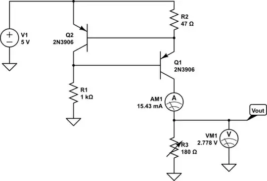

The following circuit, taken from this answer seems to give odd results when doing a parameter sweep simulation on CircuitLab. Is the problem with CircuitLab, or is there some problem with the circuit that I do not see.

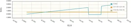

The intent of the circuit is to provide a constant current through R3 so that its value may be determined by measuring the voltage across it. When I ran a sweep which varied the value of R3 from 10 to 200 \$\Omega\$, a "notch" in the output voltage appears. enter image description here However, the \$V_{be}\$s and \$I_b\$s of the transistors look fine.

Removing either the ammeter or the voltmeter from the circuit makes the problem go away!
Also of interest, if the value of R3 is manually set between 140 and 166 \$\Omega\$, DC simulation gives the correct answer. The problem only seems to occur with DC sweep.

DC sweep tries to save time and reuse results from the previous step as a "seed". Turns out this seed makes convergence worse sometimes. I've ran into this bug many times.
The problems are twofold:
  1. Loss of output voltage.
  2. Loss of collector current on Q1.
Output voltage plot with a chunk miscalculated Collector currents, with a chunk of Q1's current miscalculated

  1. For the loss of output voltage: set shunt resistance of AM1 non-zero. 1u ohm is fine.
  2. Add a dummy parallel resistor to Q1, and switch it out of the circuit. The switch is optional for purists that worry about 1G ohm loading up the poor transistor :)
Yes, these problems are independent: fixing #1 still leaves #2 unfixed. It's a Schrodinger's transistor: if you observe the collector current, it goes into a superposition of working and non-working state, depending on which observer you ask. The pun potential mitigates some of the annoyance.
