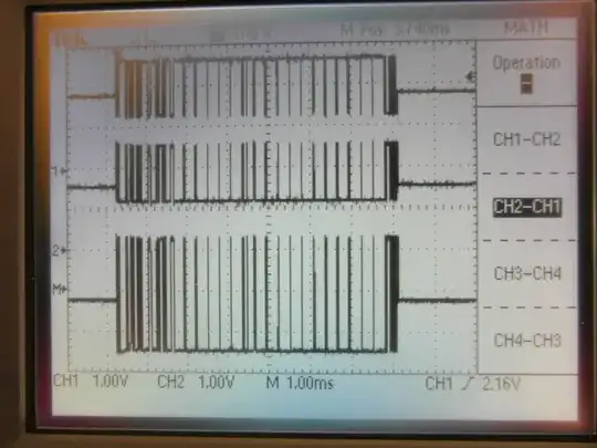

Best way to get 32768 Hz 50% duty cycle drive
While you can certainly build or acquire a crystal oscillator, I'll offer a potentially very cheap solution based on the DS3231 RTC chip (not the DS3231M) which produces a 32768 Hz square wave clock output: enter image description here
  1. The Osc is good for +/-3.5 ppm over a wide range of temperatures
  2. You can allow for crystal aging or provide tuning to adjust to better than 1 ppm.
There are downsides too:
  1. You would need to use an MCU (and I2C) to initially set up the clock chip.
  2. You need BBU as the chip is reset on loss of power. If you already have an MCU that can initialize the chip then you don't need BBU of course.
A retail DS3231 RTC clock comes with onboard BBU and typically costs less than $10
Note: You can't use a DS3231M because the chip does not produce an accurate clock (though it is reasonably stable). The time values (which is what you'd typically be using the RTC for) is set by adding or missing 32k clock cycles to keep accurate time.
