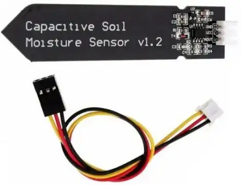

I have an MCP3008 analogue to digital chip connected to my Raspberry Pi 3b
16 -> 3.3v
15 ^
14 -> Ground
13 ^ -> CLK (p23)
12 ^ -> Dout (21)
11 ^ -> Din (19)
10 ^ -> CS/SHDN (24)
9  ^
I've connected one Pin to a capacitive moisture sensor at pin 1
capacitive moisture sensor v1.2
Using the Python library adafruit-mcp30008, when the sensor is in water its value is around 600-700, dry always 1023. The strange thing is that all the other pins flip flop between 0 and 1023 with seemingly random values thrown in. Here is a section of the logged values with the sensor connected to pin 0, and sitting in damp soil.

Any idea why there's data on unconnected pins? I tried connecting them to ground based on some article I read but no luck. Also, is that data right? Wet->Dry being 600-1023?!
