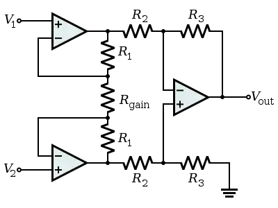

I have personally made this one, and a different similar one that also used a right leg driver that I can't seem to find, and both exceeded my expectations. They worked quite well:
