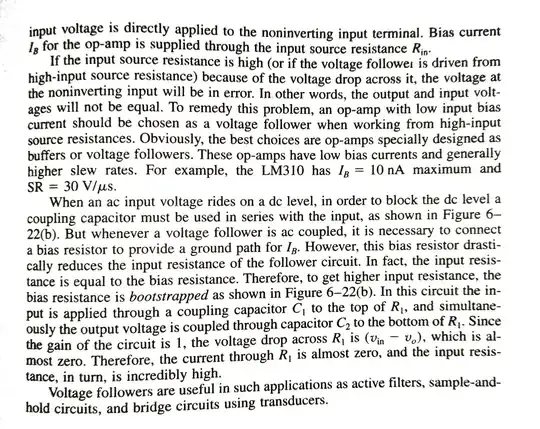

I am reading a book on op-amp and its applications in linear-integrated circuits and came across this topic of creating an op-amp circuit with very high input impedance. I believe that I understand the part about the dc-coupled voltage follower (correct me if I am wrong) where the author advises the reader to use an op-amp with a bias current in the range of nA (for a voltage follower) so that the voltage drop across the source resistance \$R_{in}\$ is minimum. This leads to minimum difference between the input voltage at the non-inverting terminal and the output voltage \$V_o\$ and hence the performance of the voltage follow is satisfactory.
Now from the part about the ac-coupled voltage follower, I understand that the coupling capacitor eliminates the dc offset (if any) in the input signal. From this document, I understood that
For the op-amp to operate correctly, these inputs must be DC biased. That is, the DC bias currents (\$I_{B+}\$ and \$I_{B-}\$), must be able to flow into or out of the input terminals.
and hence we need to add a bias resistor \$R_1\$ that connects the non-inverting terminal to the ground and creates a path for \$I_{B+}\$. Here the book mentions that:
this bias resistor drastically reduces the input resistance of the follower circuit. In fact, the input resistance is equal to the bias resistance.
Here I want to understand how the bias resistor has reduced the input resistance and how, specifically the input resistance is now equal to the bias resistance.
Then the author explains that we can fix this by bootstrapping the bias resistance. This is done by adding a resistance \$R_2\$ and connecting the output to the node in between \$R_1\$ and \$R_2\$ via a capacitor \$C_2\$ (as shown in fig 6-22(b)). As the gain of the voltage follower is 1, drop across \$R_1\$ is now almost zero (see text) and the input resistance is now high again.
I want to understand this part, please explain bootstrapping and how it is useful here and why do we need the second capacitor when we have already eliminated the dc offset using the first capacitor. Also by reducing the drop across \$R_1\$ we are now restricting the bias current so doesn't this defeat the original purpose?

A bit of a hand-wavy answer but:
The input capacitor should be chosen to appear as a short to the signal of interest and an open circuit to DC. After the capacitor, you have the parallel combination of the opamp input impedance and the bias resistance. Since the opamp input impedance is assumed to be very high in comparison to the bias resistance, the bias resistance value dominates.
The bootstrapping circuit with the feedback capacitor is neat in that it turns R1 into an essentially open circuit for the AC input signal, thus restoring the high input impedance but keeping the impedance "low" for the DC bias current which, recall, is coming out of the input which is already at Vin. The trick in the analysis is to remember that the the bias current is DC.
