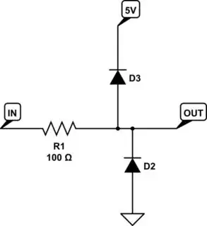

  1. Power the voltmeter from its own independent power supply, one that is not affected by what the user may do with the main output of the big power supply. This independent power supply shares the negative line with the negative output of the big power supply
  2. Feed the output of the big power supply to the measurement input of the voltmeter through a 1 kΩ resistor in series. This is a current-limiting resistor
  3. Clamp the measurement input of the voltmeter by adding two 1N4148 diodes, one between the negative supply line and the input (anode to the negative line) and one between the input and the positive supply line (cathode to the positive line). Like this:
    schematic.
    Schematic source: The Photon, How would I design a protection clipper circuit for ADC input?, URL (version: 2012-07-16): https://electronics.stackexchange.com/a/35811
