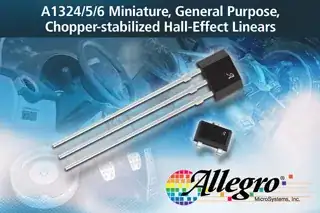

The way to do this is with a Hall effect sensor. I like the Allegro A1324.
A1324
It's a simple device. Give it 5v and 0v on pins 1 and 2. Pin 3 gives a voltage proportional to the magnetic field. You can sample this with an ADC, or you can use a comparator to convert this analogue value into a digital square wave.

  • What makes a Hall sensor a Chopper stabilized Hall sensor? Or would that justify a question on its own? – jippie Feb 20 '13 at 21:00
  • Without reading the datasheet, I would say in general the part probably have very low offsets. But yes, chopper parts justify their own question. – Matt Young Feb 20 '13 at 21:04
  • page 11 - http://www.allegromicro.com/Products/Magnetic-Digital-Position-Sensor-ICs/Hall-Effect-Latches-Bipolar-Switches/~/media/Files/Datasheets/A1220-1-2-3-Datasheet.ashx – jippie Feb 20 '13 at 21:05
  • The offset doesn't matter. This is easily adjusted for in the firmware. – Olin Lathrop Feb 20 '13 at 21:31
  • Yeah, the fact that it's chopper stabilised isn't really relevant to this application. I only mention this particular device because it's one I know well. – Rocketmagnet Feb 20 '13 at 22:16
  • I feel like 1 guy does all the marketing artwork for 90% of ic's – Grady Player Feb 21 '13 at 02:59
