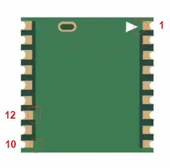

Is this pin first pin of Quectel L76 ? enter image description here
Im confused with this :

    It appears as though pin 1 is lower right if you are looking at the device top down; the triangle marking (pin 1) therefore appears at top right if you flip it over and look at the other side. – vir Sep 09 '21 at 16:53
    @vir sorry .. i dont understand your point – yeganehhp Sep 09 '21 at 17:06
    I think that you are confused between bottom-view and top-view. – Dwayne Reid Sep 09 '21 at 17:49
Look at the ground plane on the underside of the module. It connects to pins 1, 10, and 12 - Ground.
The "L76 Series (Top View)" image in the question, for some reason, is rotated 180°.
This is fairly common... I think to keep us sharp.
