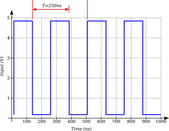

Here's a graph showing the interval (T) after which we may conclude that a pulse has not arrived in time:
I think that it's safe to choose a time constant (R1 × C1) in the vicinity of 250ns, giving rise to the values I've chosen for R1 and C1. Here I have made C1 significantly greater than the input capacitance of the inverter, so that I may disregard that gate's contribution to total capacitance.
