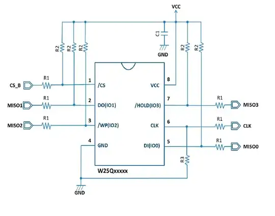

Below is schematic from the datasheet:
In our PCB we have following configuration:
  • R1: not used
  • R2: 10kOhm
  • R3: 100kOhm
  • C1: 0.1uF
We thought that problem is missing R1 in our design. So we added R1 to DO, DI, CS and CLK (50Ohm). It didn't help.
Also I want to note that even when logic analyzer was powered off, it still solved the communication problem.
Does anyone have idea on what is the problem?

You have some noise on your signals. Where that noise is coming from is anybody's guess. But hanging the logic analyzer probe on the lines provides enough filtering of the noise that it allows things to work.
You might want to experiment with putting a LA probe on one signal at a time and see if you can narrow the problem down that way. Just guessing (a SWAG), I'd say the CLK is probably the culprit.
Note that putting 50 ohm resistors at the destination end of those signals, like you seem to have done, is not going to help. Those series termination resistors need to go as close to the source (driving end) of the signal as possible.

R2 on SPI lines are not needed, WP and HOLD are different story, usually not driven by MCU.
A common value for R1 is 22 ohm, R3 isn't needed as well.
What makes yet more confusing, you call MISOx the signals that are inputs or outputs. You do have only one MISO, MOSI, CLK per SPI channel, but you could have multiple CSx, the WP, HOLD aren't part of SPI, so you shouldn't call them MISOx.

  • Thank you for help. It appears that MCU handles the pull-ups and pull-downs by itself with default software configuration except for MISO pin. So, in other words, when we have pull-up on MISO, and nothing else on other lines, everything worked ok. Then we reconfigured software to use pull-up for MISO as well, and now the setup works without resistors on CLK, MOSI, MISO, and CS lines. Reference: https://devzone.nordicsemi.com/f/nordic-q-a/53634/external-pull-up-down-needed-on-spi-nrf52840-package-wlcsp – Elvin Qasanov Sep 10 '21 at 11:57
