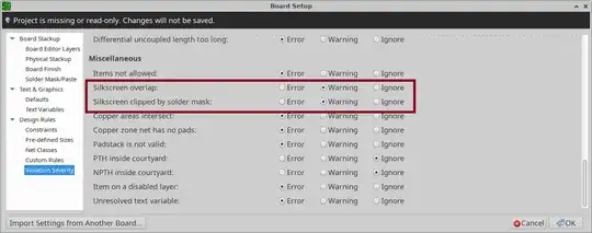

I am currently working on a PCB with a lot of components which are very close to one another. For this PCB I do not want to manufacture the silkscreen layers and I do not want the DRC to check for silkscreen errors. Currently I get a lot of "overlap in silkscreen" or "Silkscreen clipped by soldermask" errors. How can I prevent the check on them?

You can set the violation severity in your "Board Setup" dialog. Change it to "Ignore" for the silkscreen items
Violation severities

  • You are awesome =) I was halfway there....found board setup, but missed the violation severity option. Thank you! Upvoted and accepted. – F_Schmidt Sep 07 '21 at 17:21
