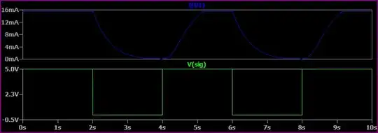

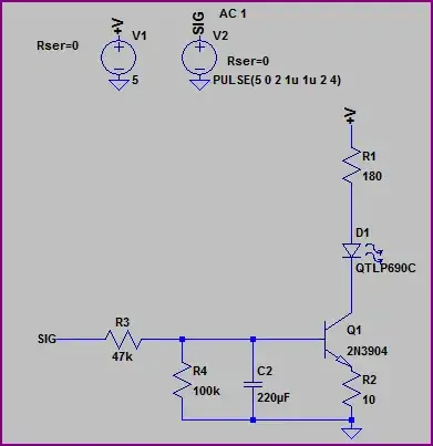

Alternatively, if absolute accuracy of timing is not so important, a simple option would be to use an RC filter and transistor switch. This way the cap doesn't have to supply the LED current, only the base current. Something like this:
Fade Circuit
Simulation:
Fade Circuit Simulation
Any general purpose NPN should do, and you can tweak the R and C values to suit.

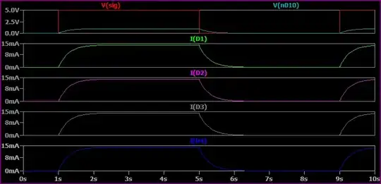

This option can easily be extended to an current mirror array with the addition of an opamp. This circuit should perform well as long as the transistors are all of the same type (supply used is +5V):
LED Fade Array
Simulation:
LED Fade Array Simulation

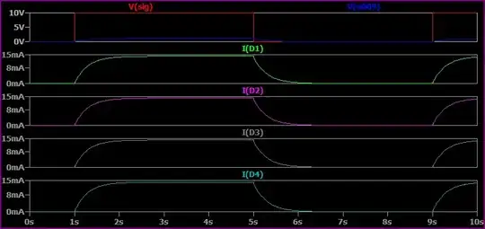

If you have a high enough supply voltage, the LEDs can go in series like this (supply used here is +10V):
Opamp LED Fade Series
Simulation:
Opamp LED Fade Series Simulation

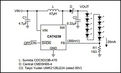

Alternatively, if you have a low supply voltage but want to drive the LEDs in series, there are lots of cheap boost ICs such as the CAT4238. This part can dim the LEDS using PWM or a varying DC voltage (details are in the datasheet)
LED Boost IC
