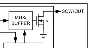

Following is the block diagram depicting the SQW output stage.
Also see the description of the SQW pin mentioning the requirement of a pullup resistor.

Both of these outputs are open drain - meaning, they need a pull up to be red properly. Adafruit probably just have made the board be used as an I2C device and it's up to you to pull SQW/OUT up if you are going to use it.

As for the SQW/Out pin, the Pull Up is only required if you are using the line. It can be disabled in the rtc's settings (Or should I say, comes disabled, needs to be turned on). Having a pull up resistor on the line, when you are not going to use it, will waste energy, needlessly draining a battery (Slowly) in battery applications. As the datasheet says, this can be left floating, i.e. no pull up, if not needed. The Adafruit device breaks it out for your convenience if you do want to use it, but you need to add the pull up externally if you want to (or use the Arduino's internal pull-up option)
