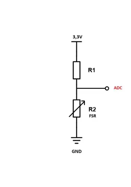

I have built a force sensor using an arduino and a self built force sensitive resistor (FSR.) The sensor system consists of a simple voltage divider, where the voltage across the FSR is measured by an ADC and the Arduino.
voltage divider
I'm trying to describe how good my sensor system is, and would like to do this by finding the uncertainty in measurement +/- newtons of the system.

Since the voltage ~ force (ADC~N) relationship is not linear, the sensitivity is not linear either. This means for low forces the sensor is sensitive, for high forces it is less sensitive. From my understanding the uncertainty in force measurement would be worse at higher forces because of the ADC quantization error.
In order to quantify the accuracy of the system would I have to perform a test measurement where I compare the newton values [N] which the sensor system shows according to the calibrated logarithmic function, compared to the force applied with the force push-pull-gauge?
How would I go about calculating the uncertainty of the system in +/- N?

  • They're not great devices, and you must load them in use in the same way mechanically as you load them in calibration. Start with "What functionality do I need for my task" instead of "how good can I get this. – Scott Seidman Aug 29 '21 at 13:43
  • " I measured the ADC counts at each force level and did 5 repeats and took the average," : 5 shots with arduino setup will not read good due to the noise. Let the arduino read continuously with a simple IIR filter. Oversampling and LPF eventually produce interpolation & decimation effect. – jay Aug 29 '21 at 14:28
There are many other sources of error too, and could compute the 3 sigma variation with your algorithm , noise, drift and voltage reference error then add them up.
